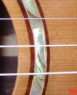

I like the way the rosette looks with the copper wire bordering the abalone. It almost gives it a stained-glass window look.
This was done because I didn't realize that my old dremel had some run-out and the channel ended up a tad wider than I wanted. I was scrounging in the workshop for something to stuff in there and came up with this. I think it was a nice "save".

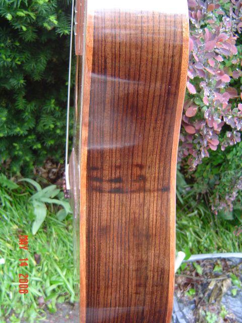

Here's where I learned about how much heat it takes to scorch the wood when bending sides. I was using an electric charcoal starter in a copper pipe. Running it wide open wasn't the way to go. In retrospect, I should have bent the inside curves first... but I added a router speed control and was able to finish up without any other issue. The scorching was so deep, though, that I couldn't get it all off without making the side too thin.

Good work, Ron. I know of people who use sterling silver wire for side dots. Don't have to worry about color change over time.

That learning curve likes to show up at just the right times, doesn`t it? On the bright side, the scorch marks are on the down side while playing...

I have an idea that would make your sides look intentionally burned{save} - take the guitar, study the burned part for a while - then figure out a nice woodburning picture you could make around?{incorporate the side burns in with} and either strip the finish and burn it yourself or have a pro woodburner do it for you - Of course this would look much better if the burn was on the topside, while playing, more so than the bottom,
How about that - I mean thats a good save isnt it>? If everyone agrees that would be 2 tubs o lard in one day!

I didn't think about turning the scorch marks into art, but it did occur to me that they're on the bottom, so I wasn't going to sweat it. I'd vote for the tub o' lard, though, Charlie. If only I could see Jesus in the burn, I'd be able to sell this for a lot of money on eBay.

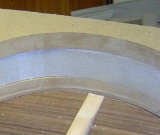

I tried this on the mold, and it didn't seem to have any downside (that I could find) so I thought I'd share. It's an MDF/styrofoam/MDF sandwich. Seemed to work okay and the molds are reasonably light. FWIW.

Oh yeah...GREAT idea on the mold...MDF is nice and straight made even better by a high density foam core...heck its simple and strong...they use this technique on aircraft...I'm not sure why I didn't think it...very clever...

I usually climb cut- moving the router with the rotation direction of the bit, first. Then go back and cut conventional. If you climb, the cutter pulls away from the needed dimension. If you conventional, inversely the bit pulls in.
   Also, clearancing the center of the cut, away from the edge helps minimize bit pull too. This is a good thing to remember if bearings are gone, or getting there.
Ron, I love learning about "how not to do something". Like your charcoal lighter experience, but I don't like seeing the results. I thank you for being honest and showing this so we all can learn.
THAT SAID!!! I really like the metal inlay!! It is giving me ideas(that's normally dangerous, but not this time). Could you tell us what you used for a glue in the copper channel? Not only is that a great fix, but a good thing to do intentionally, IMHO! I was thinking, if the copper turns green, is that a bad thing?
